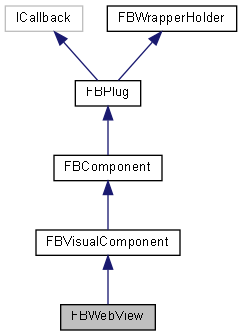

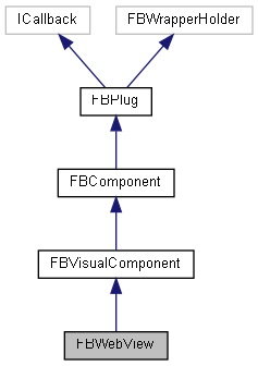

Web viewer. More...
#include <fbcontrols.h>

Public Member Functions inherited from FBVisualComponent | |

Public Member Functions inherited from FBComponent | |

Public Member Functions inherited from FBWrapperHolder | |

Web viewer.
Definition at line 2167 of file fbcontrols.h.
