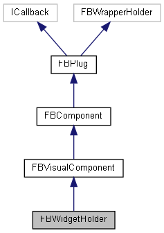

Native Widget Holder (can be used to embed native Qt Widget inside MoBu UI elements) A Widget holder provides a bridge to instantiate a Native Qt widget into MB framework.
This will be used to allow user to create UI with QT designer and hook their created UI into MB.
To allow a FBWidgetHolder to work properly, you need to specify a Creator function. This function will be called when needed to instantiate the native Widget.
Or override WidgetCreate(QWidget* pParent) function in the subclass.
/bin/config/Scripts/UI/ToolNativeWidgetHolder.py for python usage example.
Definition at line 2603 of file fbcontrols.h.
| typedef QWidget *(* WidgetCreator) (QWidget *pParent) |
typedef QWidget* (WidgetCreator)(QWidget pParent);
Definition at line 2608 of file fbcontrols.h.
| FBWidgetHolder | ( | ) |
Constructor.
| void SetCreator | ( | WidgetCreator | pCreatorFunction | ) |
Add a function that creates a native widget (a QWidget on Qt platform) On Qt, this creator function will take a void* (which can be cast as a QWidget) as the Widget parent On Qt, this creator function should return a void* (which will be a QWidget) that will be the newly created widget.
| pCreatorFunction | The creator function |
virtual |
virtual function to be override in subclass.
This function will be invoked if WidgetCreator is not set.
