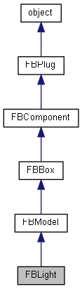

Light class. More...
#include <pyfbsdk.h>
Public Member Functions | |
FBLight (str pName) | |
Constructor. More... | |

Light class.
AreaLightShapes AreaLightShape |
Read Write Property: Area light shape.
FBAttenuationType AttenuationType |
Read Write Property: Type of attenuation for the light.
float BottomBarnDoor |
Read Write Property: Angle of bottom barn door.
bool CastLightOnObject |
Read Write Property: Cast light on object?
bool CastShadows |
Read Write Property: Cast shadows on object?
FBAnimatableColor DiffuseColor |
Read Write Property: Color: Diffuse color.
bool DrawFrontFacingVolumetric |
Read Write Property: Draw front facing volumetric light?
bool DrawGroundProjection |
Read Write Property: Draw ground projection of gobo?
bool DrawVolumetricLight |
Read Write Property: Draw volumetric light with gobo?
bool EnableBarnDoor |
Read Write Property: Whether or not enable barn door.
FBAnimatableDouble FogIntensity |
Read Write Property: Intensity of the fog (spot light).
FBVideo GoboMedia |
Read Write Property: Media to use as a Gobo with the light.
FBAnimatableDouble InnerAngle |
Read Write Property: Inner Cone angle for light.
FBAnimatableDouble Intensity |
Read Write Property: Light intensity.
float LeftBarnDoor |
Read Write Property: Angle of left barn door.
FBLightType LightType |
Read Write Property: Type of light.
FBAnimatableDouble OuterAngle |
Read Write Property: Outer Cone angle for light.
float RightBarnDoor |
Read Write Property: Angle of right barn door.
float TopBarnDoor |
Read Write Property: Angle of top barn door.
