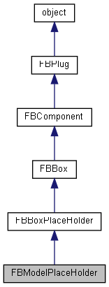

Inheritance diagram for FBModelPlaceHolder:
