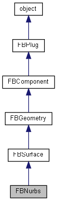

#include <pyfbsdk.h>
Inheritance diagram for FBNurbs:
