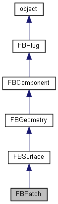

Inheritance diagram for FBPatch:

Detailed Description
Patch class.
◆ FBPatch()
FBPatch ( str  pName)
Constructor.
Parameters
pNameName of Patch.
