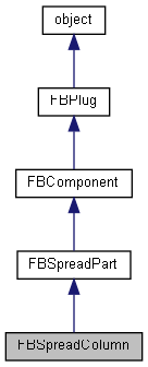

Spreadsheet column.
FBSpreadColumn | ( | FBSpread | pParent, |
int | pCol | ||
Constructor.
pParent | Parent spreadsheet. |
pCol | Column number. |
