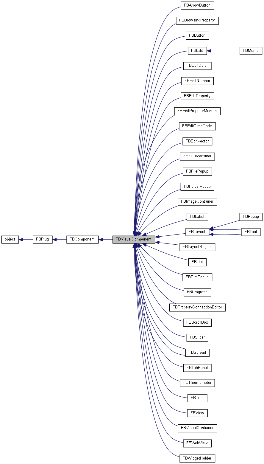

Visual Component base class. More...
#include <pyfbsdk.h>
All of the user interface elements available in the SDK derive from this class.
Constructor.
