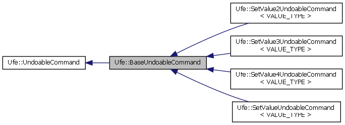

Base class for undoable set operation commands.
Definition at line 30 of file baseUndoableCommands.h.
