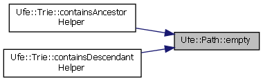

| bool Ufe::Path::empty | ( | ) | const |
Convenience method for size() == 0.
Referenced by Ufe::Trie< T >::containsAncestorHelper(), and Ufe::Trie< T >::containsDescendantHelper().
