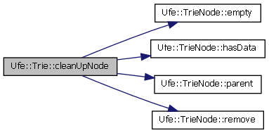

private |
Definition at line 421 of file trie.imp.h.
References Ufe::TrieNode< T >::empty(), Ufe::TrieNode< T >::hasData(), Ufe::TrieNode< T >::parent(), and Ufe::TrieNode< T >::remove().

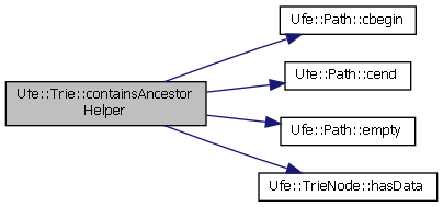

private |
Definition at line 343 of file trie.imp.h.
References Ufe::Path::cbegin(), Ufe::Path::cend(), Ufe::Path::empty(), and Ufe::TrieNode< T >::hasData().

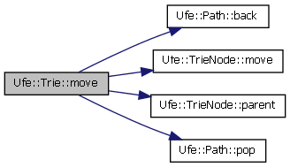

| TrieNode< T >::Ptr Ufe::Trie< T >::move | ( | const Path & | oldPath, |
| const Path & | newPath | ||
Definition at line 433 of file trie.imp.h.
References Ufe::Path::back(), Ufe::TrieNode< T >::move(), Ufe::TrieNode< T >::parent(), Ufe::Path::pop(), and UFE_ASSERT_MSG.
