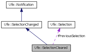

Selection cleared notification.
This class notifies observers that the selection has been cleared.
Definition at line 148 of file selectionNotification.h.

| const Selection & Ufe::SelectionCleared::previousSelection | ( | ) | const |
private |
Definition at line 163 of file selectionNotification.h.
