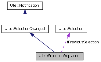

Inheritance diagram for Ufe::SelectionReplaced:

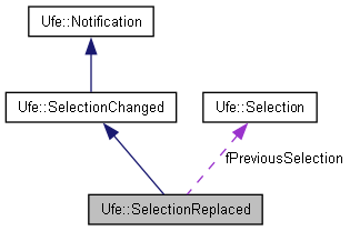

Collaboration diagram for Ufe::SelectionReplaced:
