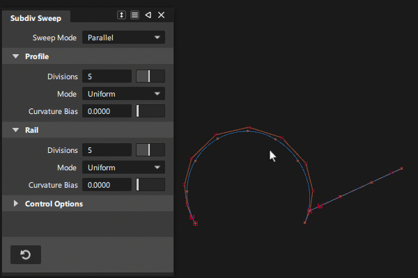

Subdiv Sweep tool
A new Subdiv Sweep tool lets you quickly generate complex shapes by sweeping a profile along a path. Select a profile curve to define the flow and shape of the subdivision geometry, and one or two rail curves to sweep the profile across. Input curves can be any type, including degree-1 curves or a chain of subdivision edges.
This tool also includes the Curvature Bias feature from the Subdiv Extrude, which lets you distribute more CVs to regions with higher curvature, making for overall smoother topology.
For more information, see Subdiv Sweep.

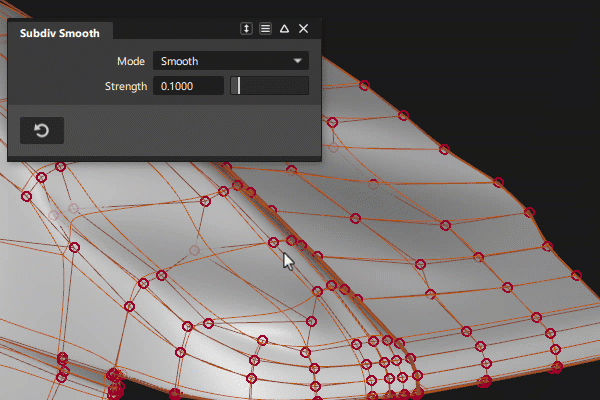

Subdiv Smooth tool
A new Subdiv Smooth tool lets you refine and optimize the shape of your subdiv model by redistributing CVs and removing zigzag patterns along adjoining edges. The tool works the same as the Relax feature in the Subdiv Retopo tool.
The tool has two modes: Smooth and Relax. In Smooth Mode, the tool moves edges using a smooth approximation curve. This removes zigzagging patterns in chains of edges without changing their length. Use the tool in Relax Mode to even out the spacing between vertices on your subdivision models, making the overall CV distribution more uniform.
Apply the effect to subdivision models using a painting motion with the LMB. The tool's focus is on the face directly below the cursor position.
For more information, see Subdiv Smooth.
