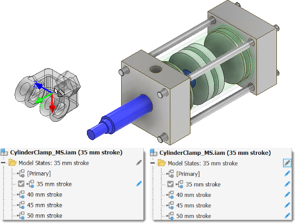

When you create model states, it is important to be aware of the edit scope status. If Edit Member Scope is enabled, changes, including changes to iProperties, are applied only to the active member. If Edit Factory Scope is enabled, changes, including changes to iProperties, are applied to all members.
You can toggle between Edit Member Scope and Edit Factory Scope in the browser by clicking Toggle Edit Scope in the browser (pencil icon) at top of the Model States entry.
In the following image, the Edit Member Scope state is active in the left browser. The clevis is added only to the 35 mm stroke model state. In the browser on the right, Edit Factory Scope is active and the clevis is added to all members.
Note: Delete is a global operation and ignores the Edit Member Scope setting. To remove a feature or component from participating in the active member, enable Edit Member Scope and edit the table.

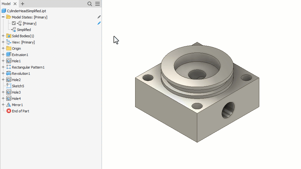

Create a part Model State
You can use part model states to capture manufacturing processes, create simplified versions of a part, or create families of parts.
Note: If you need separate files that can be managed and released, consider using iParts.
  1. Create a part file that contains the common features of the model.
  2. In the browser, right-click the Model States folder and click New.
    The active model state is copied.
  3. Assign a unique name to the model state.
  4. Toggle the edit scope to the proper setting and continue to add, modify, and suppress features as desired.
  5. Optionally, edit the iProperties to assign unique attributes.
  6. To add a model state, do one of the following:
    • Right-click the Model States folder and select New. `- Right-click an existing model state and select Copy.
  7. Assign a unique name to each model state.
  8. Add, suppress, or modify features as desired.
  9. Optionally, edit the iProperties to assign unique attributes.
  10. Double-click a model state in the browser to make it active.
  11. Save the file.
