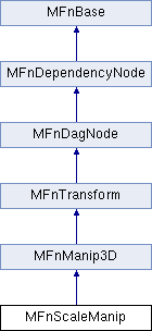

C++ API Reference
ScaleManip function set. More...
#include <MFnScaleManip.h>
Inheritance diagram for MFnScaleManip:Public Member Functions | |
