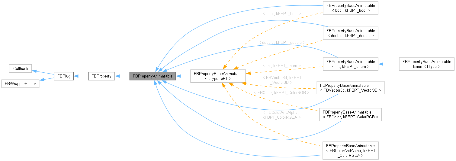

Animatable property base class.
Definition at line 1481 of file fbproperties.h.
