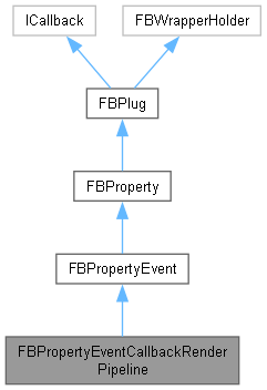

Inheritance diagram for FBPropertyEventCallbackRenderPipeline:
