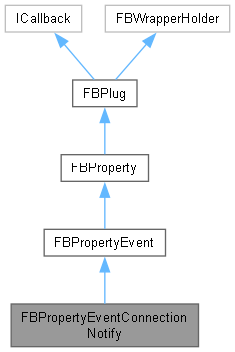

PropertyEvent: Global ConnectionNotify event. More...
#include <fbproperties.h>
Definition at line 588 of file fbproperties.h.
