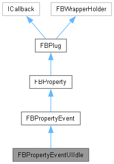

PropertyEvent: UI idle event. More...
Definition at line 572 of file fbproperties.h.
