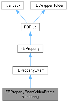

PropertyEvent: Video Frame Rendering Event
Definition at line 580 of file fbproperties.h.
virtual |
Add/Remove a callback.
