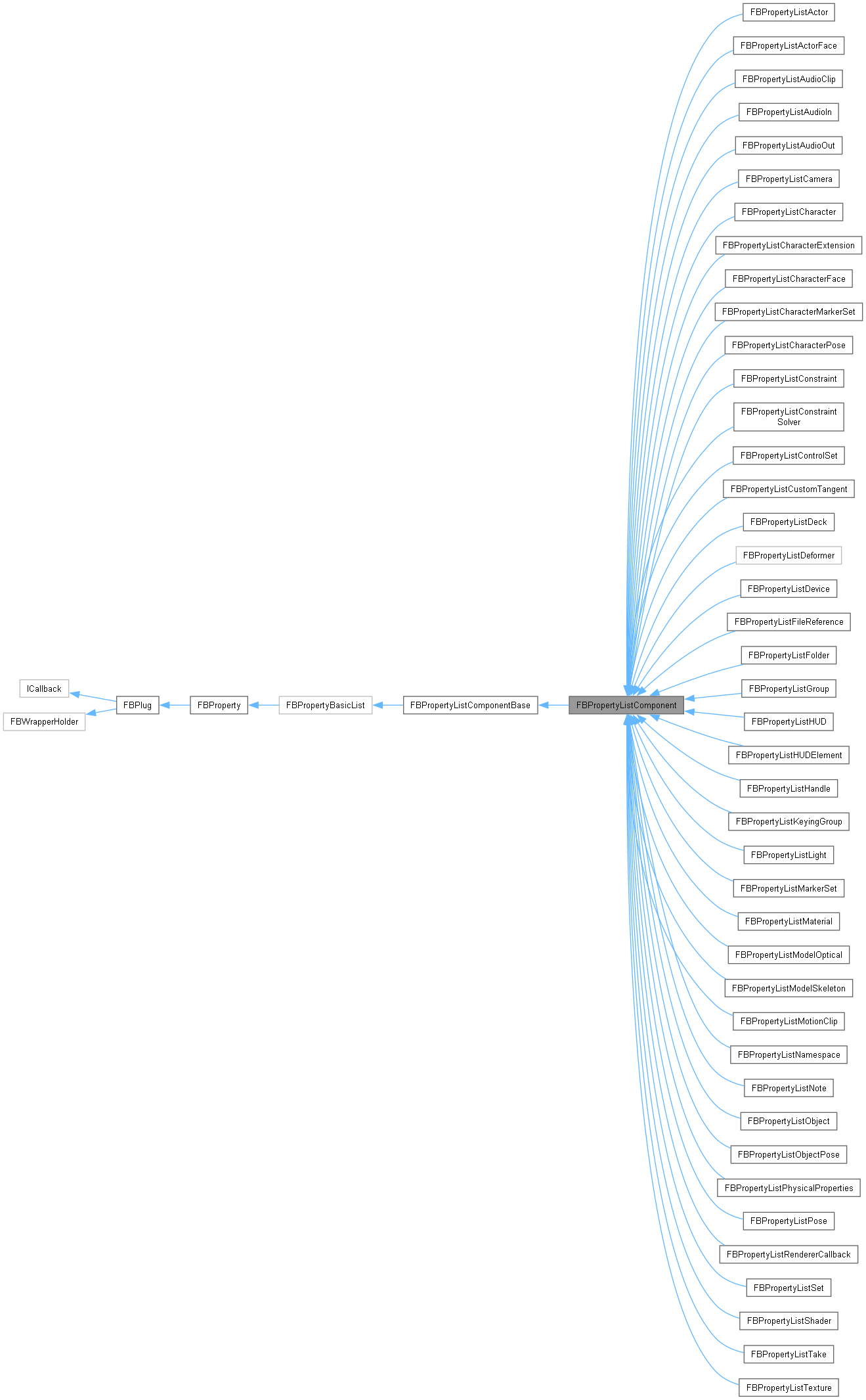

FBPropertyListComponent Class Reference
PropertyList: Concrete class for PropertyList of component More...
#include <fbcomponent.h>
Inheritance diagram for FBPropertyListComponent:
Public Member Functions
virtual FBComponentGetAt (int pIndex)
 Get the Component at pIndex.

Detailed Description
Definition at line 552 of file fbcomponent.h.
Member Function Documentation
◆ GetAt()
virtual FBComponent * GetAt ( int  pIndex)
virtual
Parameters
pIndexIndex of Component to get a handle on.
Returns
Implements FBPropertyListComponentBase.
Reimplemented in FBPropertyListObject.
