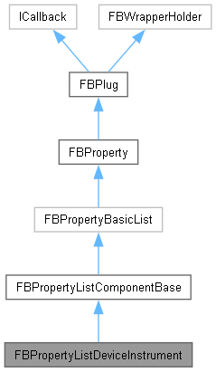

Inheritance diagram for FBPropertyListDeviceInstrument:
