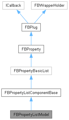

Inheritance diagram for FBPropertyListModel:
