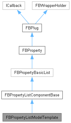

| int | Add (FBModelTemplate *pItem) |
| | Add a model template to the property list.
| virtual void | RemoveAt (int pIndex) |
| | Remove the model template at pIndex.
| FBModelTemplate * | operator[] (int pIndex) |
| | Get the model template at pIndex.
| virtual int | GetCount () |
| | Get the number of model templates.

PropertyList: ModelTemplate.
