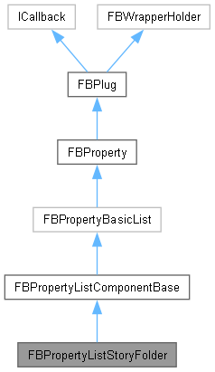

| virtual int | Add (FBStoryFolder *pItem) |
| | Add a folder to the property list.
| virtual int | Remove (FBStoryFolder *pItem) |
| | Remove folder pItem from property list.
| virtual void | RemoveAt (int pIndex) |
| | Remove the folder at pIndex.
| virtual FBStoryFolder * | operator[] (int pIndex) |
| | Get the folder at pIndex.
| virtual int | GetCount () |
| | Get the number of folder.
| | FBPropertyListComponentBase () |
| | Constructor.
| virtual int | Add (FBComponent *pItem) |
| | Add a component to the list.
| virtual void | RemoveAt (int pIndex) override |
| | Remove the component at pIndex from list.
| virtual FBComponent * | GetAt (int pIndex)=0 |
| | Get the Component at pIndex.
| FBComponent * | operator[] (int pIndex) |
| virtual int | GetCount () override |
| | Get the Component count.
| virtual int | Find (FBComponent *pItem) |
| | Locate a property in the list.
| virtual int | Remove (FBComponent *pItem) |
| | Remove pItem from the list.
void | SetClassId (int pClassId) |
int | GetClassId () |
void | SetListOfParents (bool pListOfParents) |
bool | GetIsListOfParents () |
| virtual FBPropertyType | GetPropertyType () override |
| | Get the property's type.
| | FBPropertyBasicList () |
| | Constructor.
| | FBPropertyBasicList (HIObject pParent, const char *pName) |
| | Constructor.
| FBProperty * | Init (void *pParent, const char *pName) |
| | Initialization function.
| void | RemoveAll () |
| | Remove all properties from the list.
| virtual int | GetCount ()=0 |
| | Get the number of properties in the list.
| virtual void | RemoveAt (int pIndex)=0 |
| | Remove property at pIndex.
| virtual bool | IsList () |
| | Is this a list?
| | FBProperty () |
| | Constructor.
| void | SetEnable (bool pValue) |
| | Set property enable status.
| const char * | GetName () |
| | Get the property's name.
| void | SetName (const char *pName) |
| | Set the property's name.
| virtual FBPropertyType | GetPropertyType () |
| const char * | GetPropertyTypeName () |
| | Get the property's type name.
| virtual KDataType * | GetDataType () |
| | Get the property datatype pointer.
| virtual void | SetData (void *pData) |
| | Set the value of the property, passing the type as an argument.
| virtual void | GetData (void *pData, int pSize, FBEvaluateInfo *pEvalInfo=NULL) const |
| | Get the value of a property.
| int | AsInt () |
| | Get the property as an integer.
| bool | SetInt (int pInt) |
| | Set the property from an integer.
| virtual const char * | AsString (FBDataAsStringFlag pFlag=kFBDataAsStringUI) |
| | Get the property value as a string.
| virtual bool | SetString (const char *pString) |
| | Set the property value from a string.
| const char * | OriValueAsString () |
| | Get the property original value (before any modification) as string.
| bool | IsAnimated () const |
| | Get the property animated flag status.
| bool | OriIsAnimated () const |
| | Get the property original animated flag status (before any modification)
| | Verify if property is of this type.
| virtual bool | IsAnimatable () |
bool | IsInternal () const |
bool | IsUserProperty () |
bool | IsTextureConnectableProperty () |
bool | IsReferenceProperty () |
| bool | IsMinClamp () |
| | Indicate if minimum value clamping will be applied on user input value.
| bool | IsMaxClamp () |
| | Indicate if maximum value clamping will be applied on user input value.
| bool | IsTemporaryProperty () |
| | Indicate if a property was created on retrieve because it didn't exist.
| bool | AcceptTemporaryProperty (const char *pEnumList[]=NULL, fbExternalGetSetHandler pGet=NULL, fbExternalGetSetHandler pSet=NULL) |
| | Accept a temporary property as a dynamic property.
| bool | IsObjectList () |
| | Indicate if is an instance of FBPropertyListObject.
| virtual bool | IsReadOnly () |
| | Is property read-only?
| virtual const char * | EnumList (int pIndex) |
| | Return the string of an enum value.
| FBStringList * | GetEnumStringList (bool pCreateIt=false) |
| | String list for enum properties.
| void | NotifyEnumStringListChanged () |
| | Notify system that the enum list was modified.
| void | ModifyPropertyFlag (FBPropertyFlag pFlag, bool pValue) |
| | ModifyPropertyFlag.
| FBPropertyFlag | GetPropertyFlags () |
| | GetPropertyFlags.
| bool | GetPropertyFlag (FBPropertyFlag pFlag) |
| | GetPropertyFlag.
| void | SetMinMax (double pMin, double pMax, bool pForceMinClamp=false, bool pForceMaxClamp=false) |
| | SetMinMax.
| void | SetMin (double pMin, bool pForceMinClamp=false) |
| | SetMin.
| void | SetMax (double pMax, bool pForceMaxClamp=false) |
| | SetMax.
| double | GetMin () |
| | GetMin.
| double | GetMax () |
| | GetMax.
| void * | GetParent () |
| | Get the parent of the object.
| int | GetSubMemberCount () const |
| | GetSubMemberCount.
| bool | AllowsLocking () const |
| | AllowsLocking.
| bool | HasSomethingLocked () const |
| | HasSomethingLocked.
| bool | IsLocked () const |
| | IsLocked.
| bool | IsMemberLocked (int pIndex) const |
| | IsMemberLocked.
| void | SetLocked (bool pLocked) |
| | SetLocked.
| void | SetMemberLocked (int pIndex, bool pLocked) |
| | SetMemberLocked.
| FBProperty * | GetReferencedProperty () |
| | Get the referenced property, in the case of this property is a reference property (see the IsReferenceProperty() method).
| FBScriptWrapper * | GetWrapper () |
| | Return the wrapper interface of this FBObject.
void | AddWrapper (FBScriptWrapper *) |
void | RemoveWrapper (FBScriptWrapper *) |
| bool | IsSDKComponent () |
| | Return whether or not item is an SDK component.
| bool | ConnectSrc (FBPlug *pSrc, FBConnectionType pConnectionType=kFBConnectionTypeNone) |
| | Add a source connection.
| bool | ConnectDst (FBPlug *pDst, FBConnectionType pConnectionType=kFBConnectionTypeNone) |
| | Add a destination connection.
| bool | ConnectSrcAt (int pDst_SrcIndex, FBPlug *pSrc, FBConnectionType pConnectionType=kFBConnectionTypeNone) |
| bool | ConnectDstAt (int pSrc_DstIndex, FBPlug *pDst, FBConnectionType pConnectionType=kFBConnectionTypeNone) |
| bool | DisconnectDst (FBPlug *pDst) |
| | Remove a destination connection.
| bool | DisconnectSrc (FBPlug *pSrc) |
| | Remove a source connection.
| void | DisconnectAllSrc () |
| | Remove all source connections.
| void | DisconnectAllDst () |
| | Remove all destination connections.
| bool | DisconnectDstAt (int pIndex) |
| | Remove a destination connection at a specified index.
| bool | DisconnectSrcAt (int pIndex) |
| | Remove a source connection at a specified index.
| bool | ReplaceDstAt (int pIndex, FBPlug *pDst) |
| | Replace a destination connection at a specified index.
| bool | ReplaceSrcAt (int pIndex, FBPlug *pSrc) |
| | Replace a source connection at a specified index.
| bool | SwapSrc (int pIndexA, int pIndexB) |
| | Swap source connection at index A with source connection at index B.
| bool | MoveSrcAt (int pIndex, int pAtIndex) |
| | Move source connection at pIndex to pAtIndex.
| bool | MoveSrcAt (FBPlug *pSrc, FBPlug *pAtSrc) |
| | Move source connection pSrc to the position of pAtSrc.
| int | GetSrcCount () |
| | Get source connection count.
| FBPlug * | GetSrc (int pIndex) |
| | Get a source connection's plug at specified index.
| FBConnectionType | GetSrcType (int pIndex) |
| | Get a source connection's type at specified index.
| int | GetDstCount () |
| | Get destination connection count.
| FBPlug * | GetDst (int pIndex) |
| | Get a destination connection's plug at specified index.
| FBConnectionType | GetDstType (int pIndex) |
| | Get a destination connection's type at specified index.
| bool | BeginChange () |
| | Begins a change on multiple plugs.
| void | EndChange () |
| | Ends a change on multiple plugs.
| void | SetSelfModified (FBPlugModificationFlag pFlag, bool pBool) |
| | Set the plug's self modification flag.
| bool | GetSelfModified (FBPlugModificationFlag pFlag) |
| | Tell if the plug's self has changed.
| void | SetContentModified (FBPlugModificationFlag pFlag, bool pBool) |
| | Set the plug's owned property/object's modification flag.
| bool | GetContentModified (FBPlugModificationFlag pFlag) |
| | Tell if the plug's content has changed.
| int | GetPlugConnectionModifiedList (FBPlugList &pPlugList, FBPlugModificationFlag pConnectionModificatonFlag, bool pAddRemove) |
| | Get plug's modified src/dst property/object connection added/removed List.
| bool | RevertModification (FBPlugModificationFlag pFlag=kFBAllModifiedMask) |
| | Revert the plug's modification to original status.
| void | SetStatusFlag (FBPlugStatusFlag pStatus, bool pValue) |
| | Set the plug's status flag.
| bool | GetStatusFlag (FBPlugStatusFlag pStatus) const |
| | Tell if the plug's status has changed.
| FBPlug * | GetOwner () |
| | Get the owner of this plug.
| FBPlug * | GetOwned (int pIndex) |
| | Get the owned plug at specified index.
| int | GetOwnedCount () |
| | Get the owned plug count.
| virtual const char * | ClassName () |
| | internal System vars.
| virtual bool | Is (int pTypeId) |
| | Is( int pTypeId )
| virtual int | GetTypeId () |
| | GetTypeId( int pTypeId )
| virtual bool | PlugDataNotify (FBConnectionAction pAction, FBPlug *pThis, void *pData=NULL, void *pDataOld=NULL, int pDataSize=0) |
| | PlugDataNotify when overloaded is equivalent of FBSystem.OnConnectionDataNotify but in the context of the derived object only.
| virtual bool | PlugStateNotify (FBConnectionAction pAction, FBPlug *pThis, void *pData=NULL, void *pDataOld=NULL, int pDataSize=0) |
| | PlugStateNotify when overloaded is equivalent of FBSystem.OnConnectionStateNotify but in the context of the derived object only.
| virtual bool | PlugNotify (FBConnectionAction pAction, FBPlug *pThis, int pIndex, FBPlug *pPlug=NULL, FBConnectionType pConnectionType=kFBConnectionTypeNone, FBPlug *pNewPlug=NULL) |
| | PlugNotify when overloaded is equivalent of FBSystem.OnConnectionNotify but in the context of the derived object only.
| virtual void | FBDelete () |
| | Actual destructor for a FBPlug.
| static int | GetInternalClassId () |
| | Internal class Id.
| int | mClassId |
| | Class Id.
| bool | mParents |
| | mParent.
| FBString | mName |
| void * | mParent |
| bool | mAllocated |
| | Contain the Allocation State of the Component.
| HIObject | mObject |
| | Handle on the Plug.
| bool | mSDKComponent |
| | bool Plug is an SDK component.
| static const char * | ClassGroupName |
| | ClassGroupName of the object.
| static int | TypeInfo |
| | TypeInfo.
| static int | mGlobalTypeInfo |
