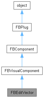

Vector edit widget. More...
#include <pyfbsdk_generated.h>
Public Member Functions | |
| FBEditVector () | |
| Constructor. | |
