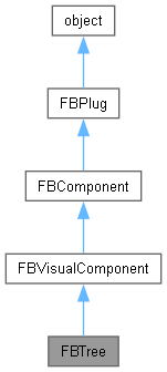

Tree list view. More...
#include <pyfbsdk_generated.h>
Public Member Functions | |
