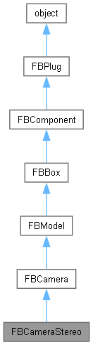

| | FBCameraStereo (str pName) |
| | Constructor.
| | FBCamera (str pName) |
| | Constructor.
