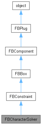

Inheritance diagram for FBCharacterSolver:
