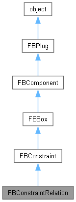

Inheritance diagram for FBConstraintRelation:
