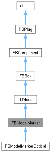

Model marker class. More...
#include <pyfbsdk.h>
Public Member Functions | |
| FBModelMarker (str pName) | |
| Constructor. | |

| FBModelMarker | ( | str | pName | ) |
Constructor.
| pName | Name of model marker. If pObject is not NULL, pName will be ignored. |
| FBColor Color |
Read Write Property: Color of model marker.
| FBVector3d IKPivot |
Read Write Property: marker Pivot Offset.
| float Length |
Read Write Property: Length for capsule (not related to scaling).
| FBMarkerLook Look |
Read Write Property: Look of model marker.
| FBMarkerResolutionLevel ResLevel |
Read Write Property: Resolution level of model marker.
| float Size |
Read Write Property: Size (not related to scaling).
| FBMarkerType Type |
Read Write Property: Type of model marker.
