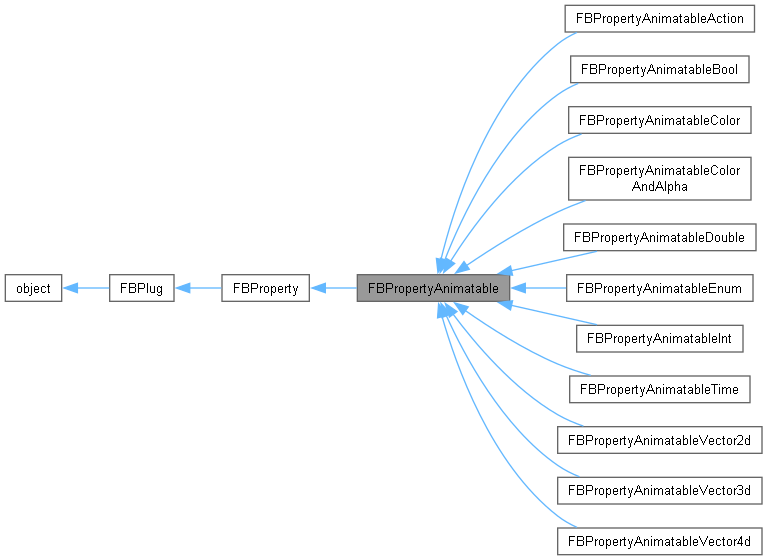

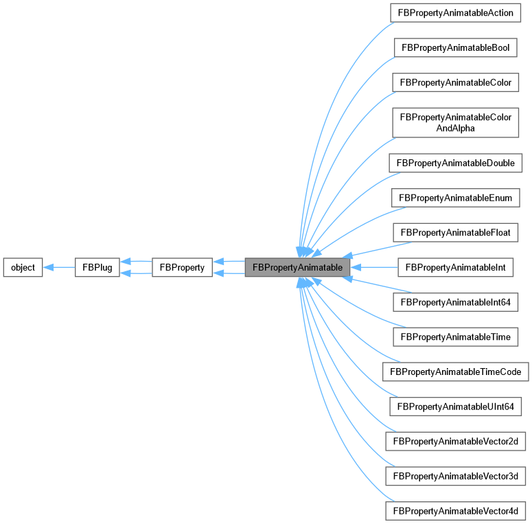

Inheritance diagram for FBPropertyAnimatable:
