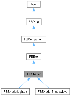

Shader class. More...
#include <pyfbsdk.h>

Shader class.
Append shader to pModel.
| pModel | Model to append shader to. |
| CloneShaderParameter | ( | FBShader | pNewShader | ) |
Clone shader.
| pNewShader | Shader to copy data to. |
Replace all shader in pModel.
| pModel | Model to replace all shader to. |
| bool ShaderNeedBeginRender | ( | ) |
Does the shader need a begin render call.
| FBRenderingPass RenderingPass |
Read Write Property: Rendering pass object are shaded in.
| str ShaderDescription |
Description.
