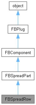

Spreadsheet row.
FBSpreadRow | ( | FBSpread | pParent, |
kReference | pRow | ||
Constructor.
pParent | Parent spreadsheet. |
pRow | User-defined reference to assign to row. |
