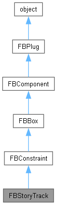

Story Track class. More...

Story Track class.
Tracks are containers for clips (medias), have a specific type which offer different functions. Note: To change the travelling node of a track, search for the "TravellingNode" property on the track and then connect/disconnect the appropriate object. Python example: lPropTravellingNode = lAnimTrack.PropertyList.Find("TravellingNode") lCube.ConnectDst(lPropTravellingNode)
See samples: CreateShotClip.py, AudioTrackSetupTool.py, BloopSlate.py, RecordLight.py, FBStoryFolder.py, VideoClip.py, PlotNonSelectedCharStoryTracks.py, PlotSelectedCharStoryTracks.py, PrintClipNamesAndStartStopFrames.py.
