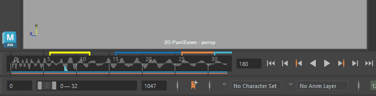

To change the playback range to the duration of the current sound file
To set the audio playback speed
Sound will play back as long as the speed setting is not set to Play every frame.
To disable sound during playback
Double-click the Volume icon
in the
Playback Options to mute the sound, or right-click the Volume icon and select
Mute. When the sound is muted, the Volume icon shows an "X" :
. Muting the volume is the same as setting the audio volume to 0. Double-click the Volume icon
to reactivate the sound settings.
Right-click the Time Slider and select .
To access the sound options for audio nodes
The audio node settings display in the Attribute Editor.
