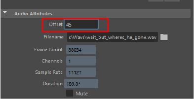

- Create audio offsets
If you want audio files to start playing at a time different from the default of Frame 0 in your scene, click the option box
next to the file. The
Attribute Editor opens with the settings for the selected audio file.
Enter the frame that you want the audio to start in the
Attribute Editor
Offset field.
Note: If you want to layer
multiple audio files and stagger them so they start at different times, see
Offset multiple audio tracks in the Time Editor, in this topic. You can also see the
Audio Offset settings in the
Import Options for instruction on importing audio with offsets.

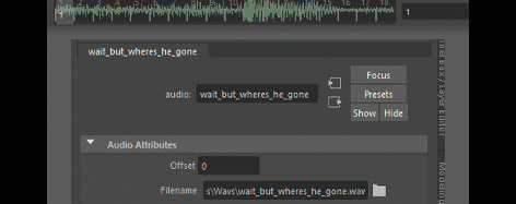

- Offset multiple audio tracks in the Time Editor
To offset an audio clip in the Time Editor
- Import the audio by right-clicking the
Volume icon (
) in the Time Slider Playback Options and selecting
Import Audio clip to Time Editor. Each audio file becomes an audio clip in the Time Editor.
- Position each file with the offset you want, or double-click the clip to access the Attribute Editor tab for it and change the
Offset setting.
- See
Add audio to the Time Editor for more.
