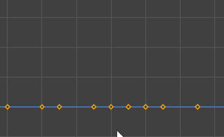

Move Only
disables the tool's ability to sweep throughout a curve's keys (see Move Over).
Graph Editor and Dope Sheet Move Only option

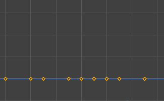

Move Over
lets the tool sweep through an active curve along the curve's keys. This expedites the fine-tuning of animation curves. This setting is the default.
Graph Editor and Dope Sheet Move Over option

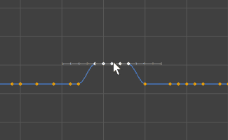

Graph Editor and Dope Sheet Ripple option

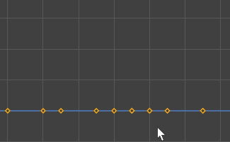

Constant
moves all keys the same amount in the direction you drag.
Linear
moves all keys based on the distance they are from the mouse down location. The amount a key moves decreases linearly as its distance from the mouse down location increases.

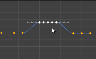

Exponential
moves all keys based on the distance-squared they are from the mouse down location. The amount a key moves decreases exponentially as its distance from the mouse down location increases.
