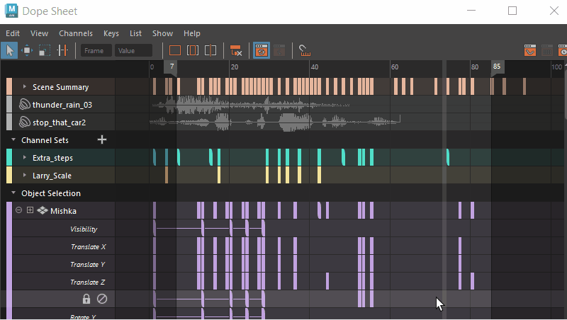

The Dope Sheet Editor (or Dope Sheet) complements the Graph Editor by letting you make large scale timing adjustments to your scene. Unlike the Graph Editor, where you can tweak individual keys on curves, the Dope Sheet Editor lets you easily edit larger sections of animation. For example, pushing animation to start later or slowing down a rotation channel

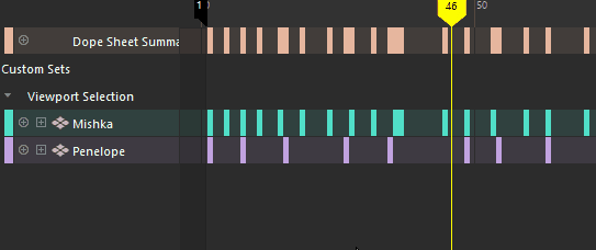

Use the Dope Sheet to manipulate key times, shown as colored rectangles in the View area. These rectangles represent time units along the horizontal axis. The vertical axis represents the items currently loaded into the Dope Sheet outliner.

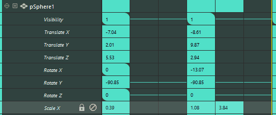

| Edit key values |
![]() Double-click a key to enter a new value. Show or hide key values using Show key value in the Dope Sheet View menu. To set the same value for multiple keys at once, Shift-select multiple keys, then Shift-double-click one of the selected keys and enter a value. ![]() |

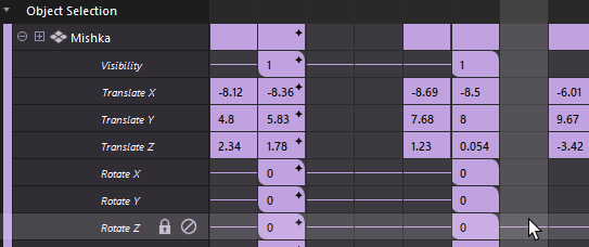

| Lock or Mute a channel |
![]() Click the Lock icon
Click the Mute icon

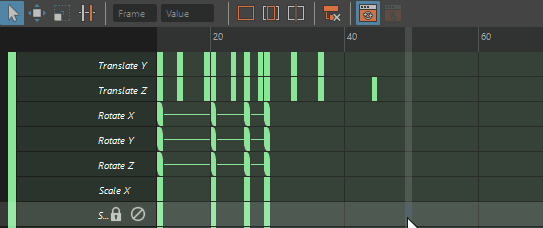

Frame all keys. |
Click
Frame all keys within the playback range. |
Click
Center the current time in the view area. |
Click
Snap selected keys. |
