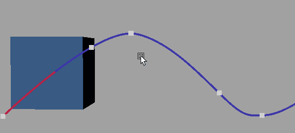

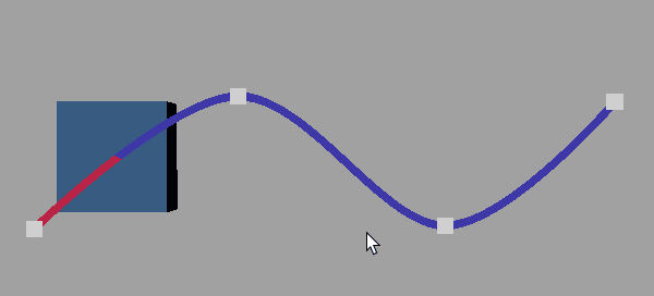

To modify keys on a Motion Trail
Right-click a Trail to view the Marking menu
This sets the Motion Trail to Add/Remove Keys mode, letting you adjust keys directly on the Motion Trail:
| To... | Do this: |
Insert keys |
Right-click the Motion Trail and select Add/Remove Keys from the Marking menu. Click the place on the Motion Trail where you want to insert a key. |
Move keys |
Select a key, press w to activate the Move tool and slide the selected keys along the Motion Trail. |
Delete keys |
Right-click the Motion Trail and select Add/Remove Keys from the Marking menu. Shift + click a key on the Motion Trail to delete it. |
Click to add a key and Shift-click to remove a key from the Trail

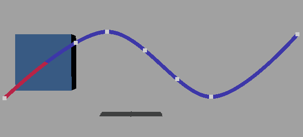

You can display and adjust timing beads on a motion trail to control the ease-in and ease-out of your animations at each keyframe. Timing Bead represent a frame in time. You can adjust the spacing of timing beads on either side of a key change the movement of the object as it approaches and moves away from the key: Stretching the timing beads slows the movement of the object into or out of the key, and compressing the beads speeds the movement up.
To display and edit timing beads
