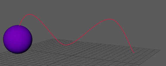

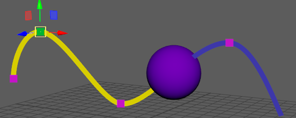

- Draw Style
- Choose when you want to view the
Motion Trail:
- Always Draw
Choose
Always Draw to show the
Motion Trail even when the object is not selected.
- Draw When Selected
- Choose
Draw When Selected to show the
Motion Trail only when you click the object.

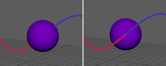

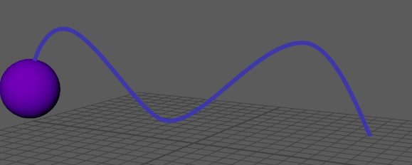

- X-Ray Draw
- Choose
X-Ray Draw to show the
Motion Trail
inside the object.

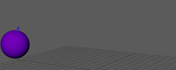

Left: the sphere passes over the
Motion Trail (default) Right:
Motion Trail
X-Ray Draw

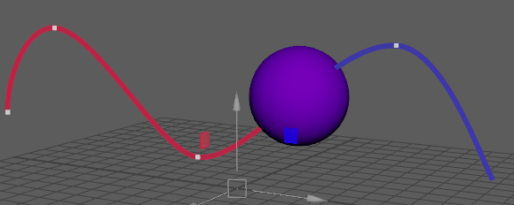

- Draw Mode
Select what you want the
Motion Trail to display:
Past/Future
- Lets you see the animation occurs before and after the current frame, by differentiating them by colors defined by the
Trail Color and
Alternate Trail color settings. (See
Motion Trail Display settings.)

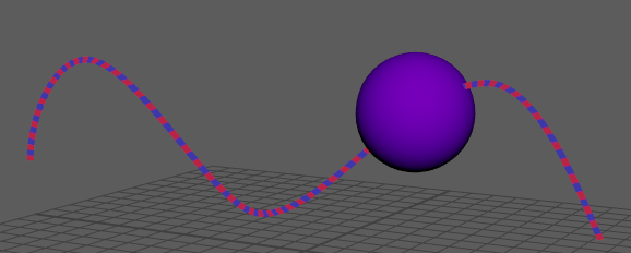

- Alternating Frames

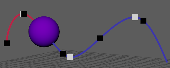

Displays each frame in an alternating color, defined in the
Trail Color and
Alternate Trail Color settings. (See
Display Settings, further down in this topic.) Using
Alternating Frames lets you see the speed of your animation along the
Motion Trail: the smaller the frame segment, the slower the animation, and the longer the frame segment, the faster.

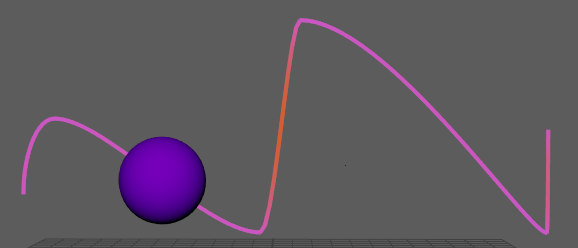

- Velocity
- Uses colors to create a "heat map" to show the acceleration of the animated object. In areas where the animation is slow, the
Motion Trail shows one color and where it travels faster, the color changes. The gradient of color the path lets you distinguish between varying speeds.
- See the
Velocity Fast and
Velocity slow colors in the set in the
Display Settings area of the
Motion Trail Editor.

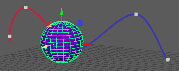

Choose how you want the
Motion Trail to show: Before
, Before and After
, or After

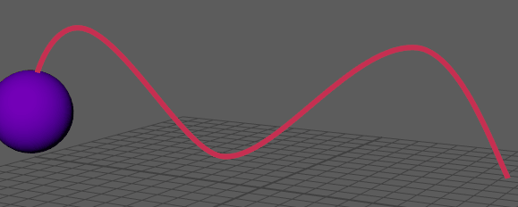

- Increment
Sets the frequency at which the
Motion Trail is sampled and drawn, essentially specifying the resolution of the
Motion Trail line. The default is 1, so the
Motion Trail is sampled at every frame. Setting the Increment to 5, for example, samples and draws a motion trail point every five frames. If a
Motion Trail key falls on a sample point, it is drawn on the trail.
Setting Increment to a larger value can increase performance, as fewer keys are drawn on the
Motion Trail. Sometimes
Motion Trail keys that do not fall on sample points may be drawn offset from the trail.

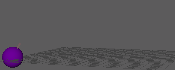

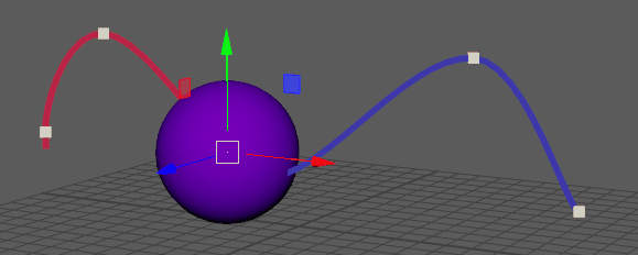

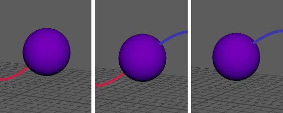

- Pre Frames
- Specify the number of frames before the current time to draw the
Motion Trail. A value of 0 (default) draws the motion trail from the current frame back to the start frame.
Pre and Post Frames set to 10 frames, shortening the
Motion Trail.
- Post Frames
- Specify the number of frames after the current time to draw the
Motion Trail from the current frame to the last frame.

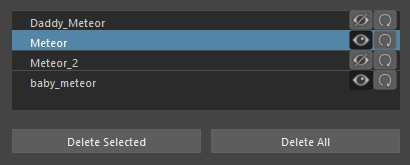

- Motion Trail List
- Shows all
Motion Trails in the scene.
- Click the Eye
icon next to a
Motion Trail to show or hide it. Double-click the
Motion Trail to rename it.
- Click the Update
icon to refresh the
Motion Trail so that it matches the Time Range shown on the Time Slider.
Motion Trail List area
Note: You can have multiple
Motion Trails on the same object. The name is incremented numerically, for example
objectname_motionTrail1,
Objectname_motionTrail2, and so on.
- Delete Selected/All
Removes either the
Motion Trail currently selected in the Motion Trail List, or removes every
Motion Trail from the scene.

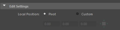

- Local Position
- The
Local Position settings let you adjust the position of the
Motion Trail relative to the source object:
- Pivot
- Draws the
Motion Trail at the rotation pivot of the object. For example, like the motion of a swinging sword, the motion at the center differs from the tip.
- When you drag the object, the
Motion Trail adapts to the new position.
- Custom
- Lets you set a custom object-space position for the
Motion Trail. Click the
Custom option to enter a specific position coordinate field, or click the
Move icon
to manually reposition the
Motion Trail.

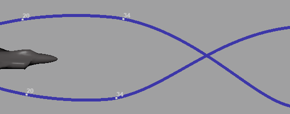

- You can have multiple
Motion Trails on the same object and use the
Custom option to position them, for example adding a
Motion Trail to each wing tip of an airplane.
Two
Motion Trails on the same object, but positioned differently

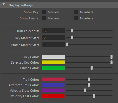

Display Settings
The
Display Settings properties let you customize the look of a
Motion Trail.

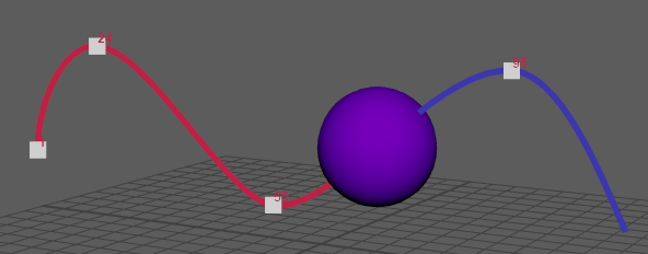

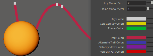

- Show Key
- Activate this option to depict the keyframes set for your object. Choose between
Markers and
Numbers. Key
markers show a square at the point in the animation where each frame occurs and Key
numbers instead show frame numbers.
Key Markers and Numbers both active
- Show Frame
- Activate this option to depict the frame numbers that correspond to the animation for your object. Choose between
Markers, which are small plus signs (+) appearing at location of every frame or
Numbers showing the corresponding frame number.
Frame Markers and then Frame Numbers
- Trail Thickness
- Lets you specify the size of the
Motion Trail. The default setting is 2.
- Key Marker Size
- Lets you specify how large the key markers appear.
- Frame Marker Size
- Lets you specify how large the Frame markers appear.
- Color Settings
- Use the slider or double-click the color swatch beside the value to choose a custom color for
Motion Trail elements in the Viewport.
Custom colors for
Motion Trails
- You can set the color of Keys, Selected Keys, Frames, and Velocity. You can also set theTrail Color and
Alternate Trail Color, when the
Draw Mode is set to something other than
Constant.
Tip: To set your
Motion Trail color to match your animated object, click the
Trail Color color tile in the
Motion Trail Editor
Display Settings to open a Color window. Use the eyedropper tool to select the color on the object.
