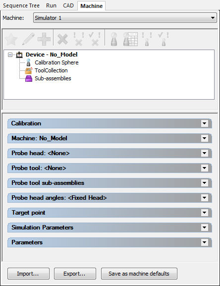

In dual-column mode, a simulator selection list at the top of the Machine tab enables you to configure and manage the probes on each column of the CMM.

  1. In the Machine tab, select the column you want to configure.
  2. Use the Probe view and the Probe head, Probe tool, and Probe head angles sections to specify the probe assemblies for the selected column.
