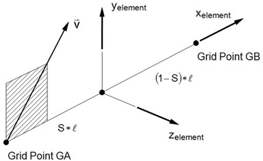

| X1, X2, X3 | Components of vector
, from GA, in the displacement coordinate system at GA (see Figure 1).
Real or blank | |
| G0 | Grid point identification number to optionally supply X1, X2, and X3. Direction of orientation vector is GA to G0. | Integer or blank | |
| CID | Element coordinate system identification. A 0 means the basic coordinate system. If CID is blank, then the element coordinate system is determined from G0 or Xi. See Figure 1 and Remark 3. | Integer ≥ 0 or blank | |
| S | Location of spring damper. See Figure 2. | 0.0 ≤ Real ≤ 1.0 | 0.5 |

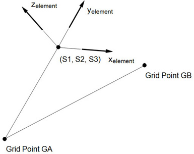

| OCID | Coordinate system identification of spring-damper offset. See Remark 8. | Integer ≥ -1 | -1 |
| S1, S2, S3 | Components of spring-damper offset in the OCID coordinate system if OCID ≥ 0. See Figure 2 and Remark 8. | Real |

Figure 1. CBUSH Element Coordinate System
Figure 2. Definition of Offset S1, S2, S3
