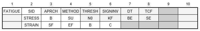

Description: Defines data needed for multiaxial fatigue analysis.
Format:
Example:
| Field | Definition | Type | Default | |||
| SID | Set identification number. | Integer > 0 | Required | |||
| APRCH | Fatigue life approach, one of the following character variables: STRESS, STRAIN, or blank. | Character | See Remark 2 | |||
| METHOD | Life calculation method, selected by one of the following values
Integer | 2 | |||
| THRESH | Percentage of amplitude threshold. See Remark 5. | Real ≥ 0.0 | 0.0 | |||
| SIGNINV | Signed stress/strain invariant option: YES, NO, or AUTO. See Remark 7. | Character | NO | |||
| DT | Event duration used to determine life. See Remark 6. | Real > 0.0 | See Remark 6 | |||
| TCF | Factor to convert DT and life output to units other than seconds. See Remark 6. | Real > 0.0 | 1.0 | |||
| B | S-N curve slope. See Remark 3. | Real > 0.0 | See Remark 2 | |||
| SU | Intercept stress level. Typically taken as the material ultimate stress. See Remark 3. | Real > 0.0 | See Remark 2 | |||
| N0 | Intercept cycles. See Remark 3. | Integer > 0 | 1000 | |||
| KF | Factor applied to compensate for life reduction effects such as finish, corrosion, and notch effects. See Remark 3. | Real > 0.0 | 1.0 | |||
| BE | Slope after endurance limit. See Remark 3. | Real > 0.0 | 0.1*B | |||
| SE | Endurance limit. See Remark 3. | Real ≥ 0.0 | 0.2*SU | |||
| SF | Coefficient of fatigue strength. See Remark 4. | Real > 0.0 | See Remark 2 | |||
| EF | Coefficient of fatigue ductility. See Remark 4. | Real > 0.0 | See Remark 2 | |||
| B | Exponent of fatigue strength. See Remark 4. | Real > 0.0 | See Remark 2 | |||
| C | Exponent of fatigue ductility. See Remark 4. | Real > 0.0 | See Remark 2 |
