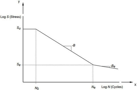

and the slope B shown in Figure 1 is calculated by:
Figure 1. Stress-Life Curve Format
