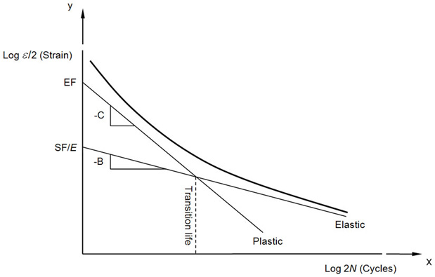

curve shown in Figure 1 is characterized by the equation:
where,
is the range of strain (
is the number of cycles to failure
is the modulus of elasticity
Figure 1. Strain-Life Curve Format
