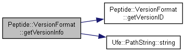

Referenced by Peptide::VersionFormat< VersionTrait >::getVersionInfo().
Here is the caller graph for this function:

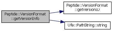

References Peptide::VersionFormat< VersionTrait >::getVersionID(), and Ufe::PathString::string().
Here is the call graph for this function:
