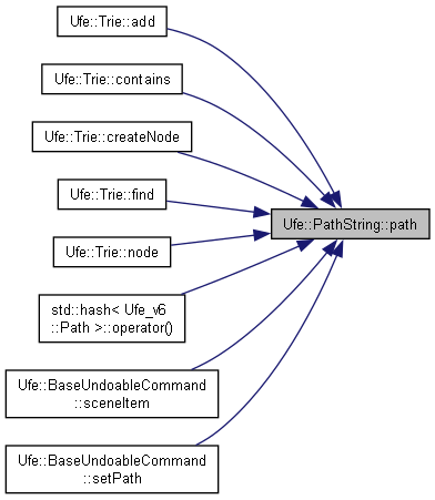

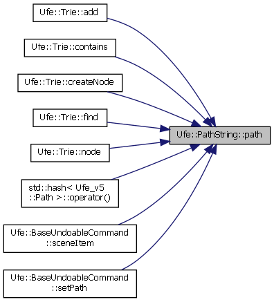

Referenced by Ufe::Trie< T >::add(), Ufe::Trie< T >::contains(), Ufe::Trie< T >::createNode(), Ufe::Trie< T >::find(), Ufe::Trie< T >::node(), std::hash< Ufe_v5 ::Path >::operator()(), Ufe::BaseUndoableCommand::sceneItem(), and Ufe::BaseUndoableCommand::setPath().
Here is the caller graph for this function:
