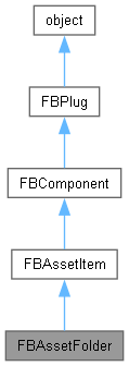

Class representing a folder stored in a version control database. More...
